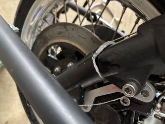

While the magnesium sliders are quite a bit lighter than the aluminium equivalent, it would appear that they're quite fragile. This is what the left slider looked like after he picked the bike up (ignore the grey bar in the foreground, it's the paddock stand). I've never seen a low-side drop do that to an aluminium fork slider. It's hard to tell what caused the break. There's no damage elsewhere on the fork leg, axle, disk or rim so it doesn't appear to have hit anything. Maybe it was just a shock from the steering hitting the stop. Who knows? The right leg was still intact.
Mg has the advantage of being less dense (lighter for the same size) than Aluminium. But for the same cross sectional area, Mg is weaker. It appears that the Mg slider above was made from an identical mould as the aluminium version. Whereas to achieve the same strength as the aluminium slider it would have needed a thicker wall.
Ductility is a factor too. Mg is more brittle (or less ductile) than aluminium. A clout that might bend aluminium could shatter magnesium.
