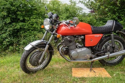

There's a nice SF on UK eBay at the moment near me (see link) fitted with Mik VMs. My brother knows one of the vendor's friends in the motorcycle profession who vouches for it, says it runs well.

Looking at the pics on EBay it looks like the cylinder head nut by the spark plugs is missing and no sign of the stud? Might be the picture but it’s leaking badly from there as well.
I doubt it's claimed to be professionally installed, also doubt it impacts the way the bike runs and am VERY certain it has fuck all to do with the question being asked by the original post.
My point is, a carelessly chucked-in-the-tooltray ignition system that initially cost a small fortune reflects more than a bit on how well that bike has been assembled and maintained. Even though it has Mikuni VMs fitted, viewing the overall condition I'd seriously doubt the bike runs at full potential, despite a "professional" opinion. Describing such a tatty heap as "nice" is very distant from what I'd consider a "nice" bike.
That’s a 1972 SF.
One could stabilise the DMC box with a dead rat or squirrel. 😉 Joking aside, at least the seller shows this messy situation in a photo, not sure if that was done intentionally though.
