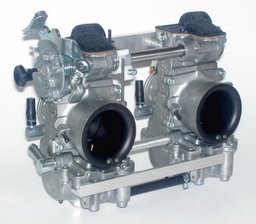

I'm pondering rebuilding my long suffering SF2 before it blows up and before there's nobody around anymore for some of the specialised work.
Whilst I'm at it, why not upgrade the carbs.
Before I splash out, are these what everybody's using?

I have 39mm Keihin FCR on my non standard SF. A mate fitted 35mm to his stock SF3 and was totally happy. A challenge is the height under the frame so they have to fit on short manifolds, not really a problem, and before I put it on the track and extended the manifold length I had it on short manifolds and the standard rubbers connected between the carbs and the stock airbox. Another challenge, for me anyway, was fabricating a connector between the two so that I could use a single opening cable (I also fit a closing cable). I robbed the synchronising parts from a useless set of carbs off some Jap bike from the wreckers, I didn't like the tiny amount of possible adjustment in the standard synch system within each carb top. I also had to very carefully bracket them together so that they are aligned otherwise they can open at different rates. None of this was particularly hard to get done, and they work brilliantly and very easy to jet. The other thing we have done is leave the acc pumps disconnected for the throttle and just use them to squirt once for cold starts, Quentin modified a choke lever to do this, I just use the little lever on the RH carb as the pump system is linked via the float bowls, dead easy. There is no slide rattle, or I may be deaf.

Hi Paul, on the 3 cylinder Laverdas, most use the RS-Series Mikunis. They look very similar and to be honest - I have no real clue what the difference is... You could ask Stephen Topham, a brittish guy living in Germany since decades, who is the importer for Mikuni in Germany. Very nice guy, helped me on my Keihin-Conversion even and he offers kits for 3-cylinders and also for Laverda 500s already (in that case TM36-150). He might help you on the size of the carbs, the differences etc. and maybe even can offer you a complete set of carbs. The price on the page that you linked above is tempting though... However, Stephen can build you a set, spaced to fit the 750's if you send him the measurements (if he doesn't have them).
Single/separated carbs is no good for this application I would say as you have two cables each carb already, one that opens and one that closes the slider. If you use 2 single carbs, you end up with 4 cables... So - a properly spaced and adjusted set makes sense, which he offers for something like 695€ for the 500's. A one-off would not be much more expensive, I am sure, as he spaces them individually anyway...
I assume though, due to the higher displacement, he will recommend you a TM38 or even TM40 on the 750's. In the Laverda-World, this sounds big but keep in mind: most Guzzi owners convert their 750's and 850's to 40mm carbs, too, same displacement, same number of valves etc. ... TMR's are also an option, but a bit more expensive. They have a very different design with steel roller bearings for the sliders. Much easier and better controlled operation. They are the top class of the Mikuni range.
I have 41mm carbs (Keihin FCR) on the 1200 Laverda (well - 1116 or so) and they work well. You'll need to adopt your right hand though to the carbs, as they are much more "snapy", but also can cause a stubborn driving behaviour if you pull them open to quickly...
Good luck and let us know how you like them!

Thanks Lothar, but it's a rather long term project, first do the crank, valves, guides and a rebore. But the again, who knows.
