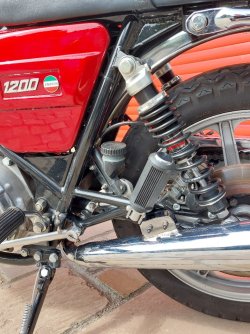

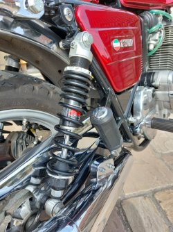

1000017189.jpgHad the Falcon shocks on for a few weeks now and they've improved the ride no end .Look good and didn't cost the earth, around the £450 mark.
Definitely worth considering if you're after new shocks...
