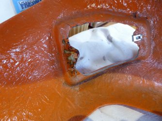

Finally ! Getting around to fitting my Jota fairing but I need details/photos of exactly how the turn signals
mount and are secured in the fairing. I would absolutely like to duplicate the factory method.Thanks

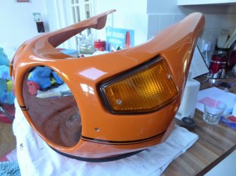

Hi Greg,
Great choice of fairing which gets the thumbs up from me, although many prefer the "Naked" look I absolutely love it.
Regarding the indicator mounting I can only show you how mine are fitted which is how the bike came to me,you will find that they are not exactly a precision fit but with a bit of care and attention to detail you will soon have them fitting securely and looking the part.
Pure 80's styling I originally thought they were caravan indicators but after a bit of research found out they were from an Autobianchi A112, anorak stuff but nice to know I guess.
Anyway here's some photos showing the "clip nut" arrangement which the Indicator body and lense secures to,hope this helps?
Steve
