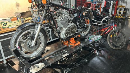

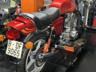

I have just finished what may be my last Laverda project, I don’t have any other on the line at least… I am only missing the side badges, but I only put them after successful first kilometer… strange old habit. The engine started already but still haven’t test it on the road.
Technical question… I installed completely new clutch discs, when I pull the clutch lever, they get sticked, I have to make some force on the wheel with my hands but they then get free and I can turn the wheel freely. I release the handle and press again and they are sticked again…
I am a bit concerned how they will behave on the first ride… never happened before! Maybe after some use it will behave as expected?? Any experiences?

Nice work indeed, Miguel. And a nice little collection of bikes there too!! I wouldn't worry about the clutch until you've started it and can see whether it disengages properly. I've never tested a clutch 'statically' like that.

sticking clutches are very often oil brand related. Try a different brand of common or garden 20/50 engine oil suitable for diesels, better still, air cooled stationary diesels. I have never bought bike specific engine oil. I have used many brands, at one time SAE30 for London double deck busses (dont ask) and generator oil (dont ask again) I have never had an engine falure due to the oil, in fact I have never had a Laverda engine bearing fail ever! broken valves, melted pistons (quite a few) and blown head gaskets (pre copper type) but never an oil related issue.

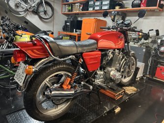

Now I put some photos of the finished result
You may only critisize the orange Marzocchi!!🤣🤣🤣

Hi Miguel.
I Can see you still use the: Triplex chain 🧐 You Can use 2 single chain, loke RGS / SFC 1000 engine 👍👍
You have buildt a fine bike 👍🥇👍
