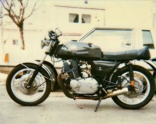

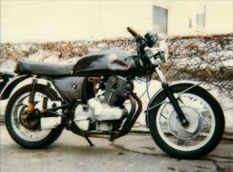

Quite nicely. Fortunately there were no holes in the tank, so I used a bent metal rod to push it out from the inside, then used bondo to fill the small dents. Ended up lining the tank anyways because of the rust inside. Put filters on the fuel lines, but they never collected anything. Here's a shot from the other side from when I got it.
You don't line a tank because there's rust inside. Unless it's fibreglass, you line it because it's full of pin prick holes.
If it's rusty, get rid of the rust.
A lot easier to get rid of rust than to get rid of a liner.
