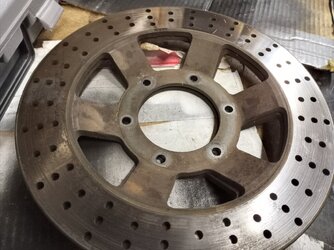

I have taken apart a bit of the bike and have been working on stripping and repainting the center of the brake rotors back to the original black and rebuilding the calipers. Have removed the fork stanchions and replaced the fork seals . I have also removed the headers and y pipe and sent it all out to be ceramic coated. I was wondering if anyone would recommend trying to replace/convert the heavy drive chain to a smaller gauge? Thankyou very much for the help.

Ronnie gave me the name of a private tire changer I'll try today for my BT46s. I'm looking into replacing the heavy solid rotors w/ lighter stainless.
