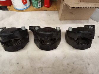

thanks for getting back to me. I realize the valve on the top is for air pressure; I was wondering about the screw on the back with the O-ring; it looks exactly like the drain screw on the bottom of the Marzocchi forks. I just assumed oil went in there? I will end up upgrading the shocks for sure but was just curious. Anyway, I'm psyched that I have the fork seals changed out, the calipers rebuilt and the new brake lines ready. Just waiting for brake pads and other items to arrive in the mail from Wolfgang.
