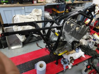

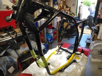

So you are going with OrangeA lot of work has been done since I posted this thread. The frame and ancillaries have been powder coated, the engine is away being given a make over, and everything that is chrome, has been rechromed. I've started working on refurbing the many parts that haven't been replaced or renewed. The starter motor has come under scrutiny today, and it looks like the commutator is going to require a skim, as when you put a steel rule across it, there's a discernable dip in it where the brushes run. The rest of it, apart from being a touch mucky inside, is looking in good order.
