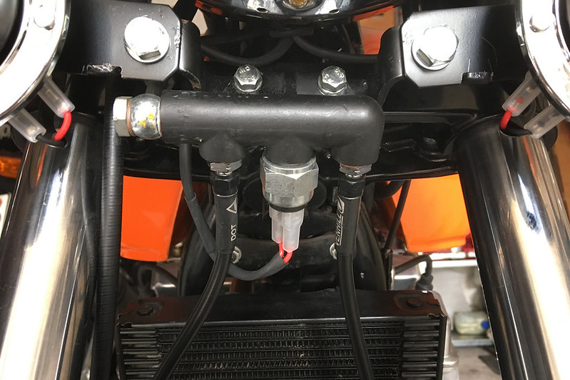

Here a picture showing the horn mounts to the lower fork clamp:
Mine is 1907 - so very early one with oil cooler ...
Cheers
Jo
