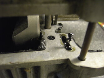

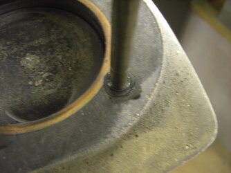

Engine is leaking oil at primary chain cover and cylinder base.
Measuring was done with engine warmed up at crankcase / oil cooler output port.

ALL OF THE PUMPED OIL GOES THROUGH THE COOLER, the only pumped parts are the six cam bearings and the centre main bearing on the crank, the remainder is fed by splash, and gravity drainage, that includes the outer main bearings. There is a "flooded" oil gallery at the base of the cylinder block (closed by the base gasket) which is fed by a single very small feed hole directly from the pump/oil cooler.A leaking gasket in this area is not at all common, there is only one way in for the oil to this gallery, but eight ways out, which are the four external cylinder stud bores and two more for the centre cam blocks, all these six stud bores carry oil up to the cam bearings where they spray bleed and puddle oil to the head, the other two are internal direct drillings from the gallery to the centre mains, where oil is splashed everywhere by centrifugal force (after trapping cack in the slingers) this includes pistons, rods (both ends) and the outer mains.
block this "flow" at your peril, EG the oil cooler or the external lines.
Unlikley, but is is possible that a base gasket made without the feed hole to the oil gallery has been fitted, only, happened a few times many years ago, but you never know.

Perhaps Peter T it may be a "weep" in the area you describe, happens with some builds, the correct o ring needs to be fitted on motor assembly. Material for this Oring is also a key parameter, Oring compression set is an underlying point of possible failure when substituting alternate Oring size. Photograph of the actual area will be of use in, making clear what is being discussed.
