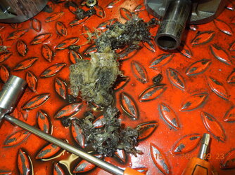

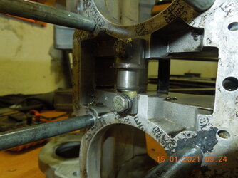

Piet,were those two silicone horrors the same engine, I will bet the head gasket didnt leak!
No Clem, different engines.
Top is a 750 crankcase, bottom is triple head gasket, obviously.
When warm, the 750 system tops out at around 1.5-2bar, with SFC-type pump. Triple shouldn't have much more, given it has a couple of plain bearings for the cams, but these have very generous clearance, nowhere near as tight as a plain-bearing crank or conrod.
Sadly, I don't have pics of all the silicone horrors I've found, some have been absolutely gobsmacking!:rolleyes:
