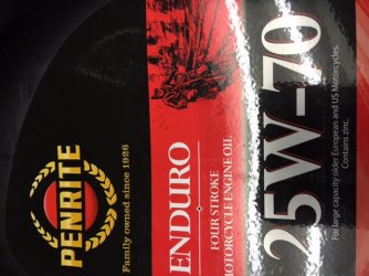

2nd bottle now. Oh, and I don't think Castrol oils are as shit as they are being portrayed. Lots of folk will balme anything rather than their own lack of ...
