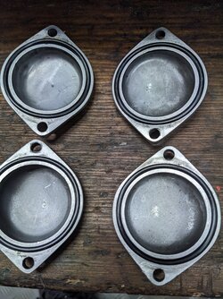

Tappet adjuster covers are tapered, unlike the sf2. One fitted upside down, but which one?
Have I just found the tapping noise it got sidelined for?

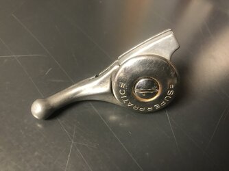

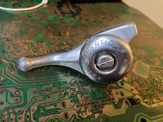

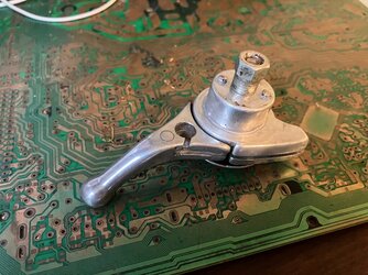

Wolfgang has/had sponge airfilter kits. I have this choke lever available if suitable and required. NOW SOLD , thanks.

Funnily enough, the tappet cover that was upside down, ie, wide part to the bottom, is the one that didn't get smacked. Other 3 have witness marks.

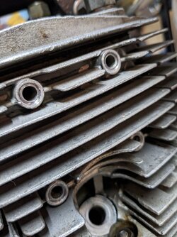

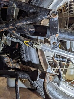

Heaps too much feeplay side to side in the tappets, so multiple head issues. The "restorer" back in the US seems to have had a dislike of washers, nuts and bolts assembled everywhere have bitten into and damaged the alloy. The rear brake arm worries me deeply.

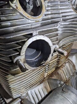

Exhaust gaskets not sealing at all, sucking oil down the guides.

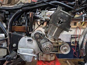

The top engine bolts don't line up. DPO has elongated the holes in the frame. OMG.
