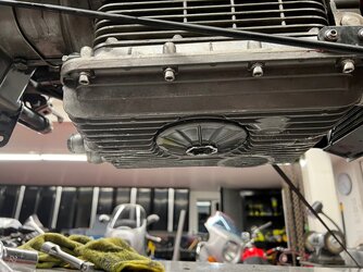

more progress tonight, all the stripped fasteners out of the oil pan, oil pan off and cleaned, new metal crush washers on oil lines, new oil filter, etc.
most time consuming was installing three thread inserts into the bottom of the engine, three of the rusty oil pan fasteners were in so tight when I welded nuts on them and forcibly spun them out, they brought the case threads with them. New pan gasket, new O ring for filter access port, the round filter access port was cross threaded, cleaned it up with a thread file and got it back in, but I am now looking for a new used oil pan, the one I have also has a weld repair and various broken fins....
I guess that's better than the bolts breaking off in their holes, necessitating some kind of extraction process. Threads are an easy repair, especially as it seems you already have the inserts.
HI Cam, I went through a lot of those thread inserts when building the 1957 Gilera 150,seemed like most of the bolt holes in that old engine were stripped out. I ordered several packages of them from McMaster Carr summer of 2022, handy to have extras around. Relatively easy to install, especially after having had to do a number of them in awkward places.... These particular inserts are "pinned" into place with the two stakes you see in the photo above .There is a "special tool" to install them, but as you need a tool for each different size, I go without the special tool and use my own technique, hasn't failed me yet.

Centauro sump on uk EBay at the moment £125
that is in much better condition than the one I have. Listing says may not ship to Canada, so am contacting seller. Thanks for the link!!
EDIT - filled Guzzi engine with $75 of Amsoil Synthetic oil, now slowly leaking back out through the cracked sump....... Also found several other used Centauro bits on eBAy UK I haven't been able to find anywhere else, am contacting various of those sellers about shipping to Canada
thanks to Exmoor Beast for pointing me to eBay UK for the oil pan. Seller initially reluctant to ship to Canada, but when I agreed to buy enough stuff, seller agreed to ship. Seller of the Centauro oil sump also has most of the other parts I have been looking for, except a set of stock mirrors. Seller good enough to post all the other bits with an agreed buy it now, which I have used and purchased, and they will ship in the same box when I "win" the Centauro oil sump, which ends in another day and a half.

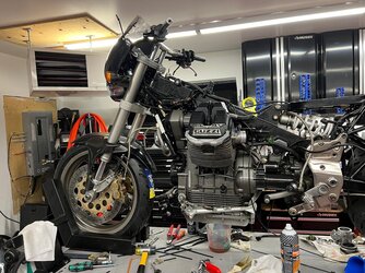

current state of progress, photo attached. The measuring cup under the engine is how much expensive fresh synthetic Amsoil 5w 60 oil has leaked out of the cracked sump in roughly 24 hours, bloody hell..... No wonder the entire rear of the bike was heavily coated in oily crap, must have been running like that by previous owner for quite a while, just repeatedly topping up the oil level. :rolleyes:

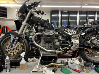

another several hours on the bike re assembly today (Sunday), all the wiring connections made, headlight on, cables run, test fitting windscreen, need to make top fairing mounts, repairing various issues. Couple of photos. After another several hours bike look's about the same......:rolleyes: Amazing how much time doing things right sucks up.....

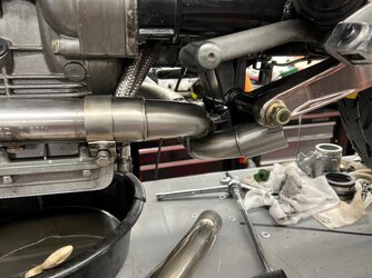

the Guzzi exhaust, except the mufflers, is all stainless steel. In the case of my bike, heavily yellowed, header pipes almost orange, and heavily stained. 3M ScotchBrite, first the green coarse larger pad cut into strips, then the finer versions, brought the stainless back very nicely. Now too whitish, but the stains are almost all gone, and the pipes will yellow back up soon enough. "Trick" is go with the grain, around the pipe a small section at a time, with a lot of pressure, then clean with brake cleaner. Heavy manual labour, bloody hell......:eek::eek::rolleyes:

well, this time I left the main part of the spine frame attached to the engine, I have not stripped the engine down to the crank, and I am not painting anything. I still don't even know if the bike runs...... :ROFLMAO: :ROFLMAO: :ROFLMAO:
$10 worth of coarse green ScotchBrite and a bit of manual labour sure made a difference with the pipes though.
