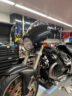

still progressing while waiting for parts in shipment including waiting on fuel injection parts, clutch lever perch, replacement oil pan, etc.. I have now sourced and bought everything I should need to complete, (and waiting on shipping from UK, Italy, and USA) except mirrors. I have sourced a supplier in Italy for the stock mirrors, but have been reluctant to spend the $300+ for (really ugly) new stock mirrors and am still looking for a pair of used (ugly) stock mirrors, or I may go a different route for mirrors altogether.

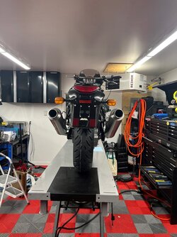

have the seat on to set rear suspensions sag while the monoshock spring adjuster is still relatively easily accessible. Going to press my spouse into service to measure my sag and help correct the situation....... ;) :ROFLMAO: (y)
dealt with proper mounting of fork mounted windscreen, other than the oil pan swap which will be straight forward, and multiple final assembly issues, remaining main task is the fuel injection system once the parts and new sensors arrive. I have a Weber Magneti Marelli fuel injection manual, this should be interesting.

haven't been able to lure my spouse out to the garage just yet to play with my sag.

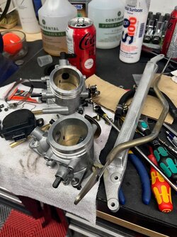

Running fuel injection bits like the injector bodies, linkages, etc., repeatedly through my ultrasonic tank in the garage, but no way to properly clean the Weber injectors in my garage.
Found a local high tech auto tuning shop today with the proper ultrasonic fuel injector cleaning tech, so dropped the GuzzI Weber injectors off for cleaning. They tell me they "pulse" the injectors continuously in an ultrasonic tank while pumping some sort of cleaning solution through the injectors, for "a couple of hours". Injectors supposed to be ready for pickup tomorrow.
Rest of the fuel injection stuff still in shipping transit from Italy and the USA. Also still waiting on the water jet cutting place for the base plates for the Guzzi cam belt tensioning tools.......:whistle::whistle::whistle:
EDIT - just noticed in the photo below that there are 2 cans of Coke Zero on the work bench. Bloody hell, pancreatic cancer surgery and resulting insulin dependency, used to be numerous cans of beer.......:mad::(:censored:

Convincing someone to assist with sag has been my issue on occasion. There is a magnetic gadget with an attached tape that allows you to do it on your own. Pretty expensive though.
Hi Vince
by the time I could get that cool digital system here to me from the State of Oregon in the USA with currency exchange, shipping, and duty and taxes, would be close to $250 Canadian. A bit too pricey for me for occasional use. I am going to set rear sag of the Guzzi on the air lift service table with the front wheel in the wheel vise, a scissor lift under the oil pan, an assistant, and a tape measure.
This explanation from Richard Backus of Motorcycle Classics magazine to measure and set rear sag with a tape measure is as good as any I've seen
That's a nifty little tool Vince. Better than a wife for that job I think (wives probably have other uses though).
I'm wondering if you could use one of those laser distance measure things (electronic tape measure). As a bloke with history in the building industry, you probably already have one in your tool box. I have one that reads to the nearest millimeter. Tape it to the bike with it pointed at the floor and take readings with no load, static load and rider load, then do the arithmetic. You might have to crane your neck around a bit to take readings, but it should be possible.
No, I don't have one Cam but that's a pretty good idea, getting help is always a lottery I mostly lose.

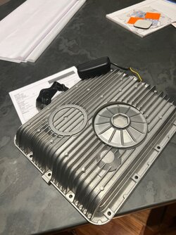

still waiting on used parts shipments from Italy and USA, but the parcel from the UK arrived by DHL. Used Guzzi Centauro oil pan and some other bits. Looks like the seller vapour blasted the oil pan for me, looks new. When I removed the bashed and broken one again the other day another of the screw threads stripped out, so have to drill out and install another thread inset
