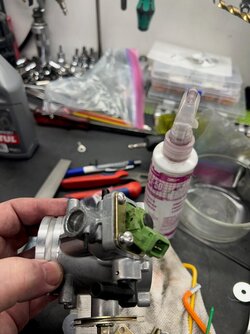

have started with fuel injection re assembly, very primitive fuel injection. Has a mechanical Rube Goldberg sort of cable operated "fast idle" mechanism operated by a lever on the handle bar. I totally dis assembled everything, multiple passes through the ultrasonic, and am now mechanically synchronizing everything using the adjustments in the linkages. I am using all new stainless steel fasteners. Was interesting re assembling and adjusting the fast idle mechanism....... ;) :eek::rolleyes:
I found a local car tuning shop with the proper ultrasonic injector cleaning equipment, took both injectors in. One injector was half plugged, the other wasn't great either. They put the injectors in an ultrasonic cleaning bath and "pulse" the injectors through various rpm ranges. Apparently took three hours pulsing in the ultrasonic to get the pair back to proper and equal operation. $25 per injector, thought it was money well spent, especially as I could not find new injectors to buy..
I am now again stalled on the fuel injection re assembly waiting for the custom machined parts from the USA for the left side injector housing body.
The ECU for this bike has been "chipped", and I am running the Marvic X pipe crossover and open mufflers I got from HelicopterJim. Not sure how much adjustment is available other than basic mechanical synchronization of the injector body butterfly's, need to go through the Weber Magnetti Marelli injection manual soon.

Hi Paul
As far as I know the "Creedon Chip" is meant for that crossover and de-restricted pipes so hopefully it won't need much more than Throttle Body synchronization. It has been a while since I looked up the info on the COG site but as best as I remember it was not meant for the stock exhaust system. If I remember correctly it works well with that crossover and pipes as well as the full Termignoni system (very rare now) and also the full Staintune system.
Good show on getting the injectors cleaned. It will be fun to hear how this project turns out! You can go smoke Francesco on his Daytona!

I like the look of the Jefferies ECU, bit likely a step too far for now, I need to get the bike to its first start up and make sure it actually runs first....... :ROFLMAO:
the rest of the fuel injection parts and sensors arrived today, so going to see if I can get to trial start up stage by end of the coming weekend
