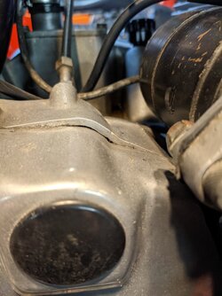

76 cases, but gearbox cover has crossover boss, doesn't line up at the top. Did they change the shape of the cases?
Marty,
The case shape wasn't changed... at least not on purpose. The sprocket covers tend to warp and distort in that area, especially if they have been slotted for a long clutch lever. Has always puzzled me too, can't see an apparent reason! I'm suspecting the clutch actuation to bend the cover, the cover is for a large part unsupported.
drive chain has broken in the past and punched the case up, seen and repaired heaps of those issues
I had one break out completely and it bent the shaft, making the time taken to find, refit the chain a total waste, was stuck in top gear, thia was a 2am in France on Autoroute du Sud, the chain was a new Regina copper plated job and had done less than 300 miles, right side of bike was covered in copper filth, not a happy bunny, the old knackered chain, would probably have lasted the trip to Bol D'or and back!
