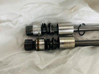

Next problem, does the seal orientation make a difference ? See picture….on the brand new assembly (top one) that came assembled it’s orientation is different to the old ones in the bike (bottom)….advice appreciated as usual

That’s brilliant many thanks for that link, really useful. I imagine the piston orientation likely doesn’t matter then although they did reverse it for some unknown reason
