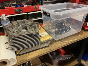

....come on, what happened to Monty?
Hi Lee, been a bit busy so late reply..
Traced to a locked cam block.. some oil supply issues I expect as only 1 of 4 jammed up.. unfortunately would not release so we had to sacrifice a cam chain to get the motor apart..:confused:
Anyway, boxes of bits, lots of choices.. we'll get it sorted and have crack again next year..
Ya Gotta Love Ya Racing.. Laverdas..:p

Does Red run the same clearances on the aftermarket blocks as OE ? Looking at OE they appear to be cast - LM25 equivalent maybe.
The aftermarket ones are obviously CNC from better material. Anyone looked at the different expansion rates ?
Reason I ask is that I can't see any heat discolouration which I would expect if it was just lubrication.
Don't know Greg,
I got these blocks from an O.S. supplier.. 2nd set, I already have others installed in the Formula head with no problems..
Good point though, some measurements required as part of review of the last build.. only 1 jammed, rest were OK.
Love those racing motors.. ;)
As my old mate Mark M always says.. "show me a man with a motor and I'll show you a man with a problem.."
