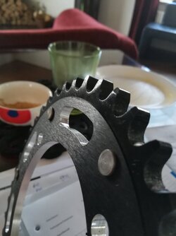

Carrier is 6,85mm thick, mounting face is flush with the rear surface of the toothed ring.
Only small issue maybe the distance between the inner edges of the rivets (157mm) and the mounting surface hub diameter - anyone know what the hub diameter is (1000 3CL series 1 - thin web FLAM)?

Shame they can't use a countersunk head on the inside rivet. I don't think Lav owners are going to want to remove metal from their sprocket carriers to clear the rivet head.
I wouldn't be surprised if they can use countersunk rivets on request. Rivet heads fouling the hub is unlikely be a problem only isolated to Laverdas. Even if they can't, you shouldn't have to remove much metal from the hub. Just mill out pockets large enough to accommodate the rivet heads.
