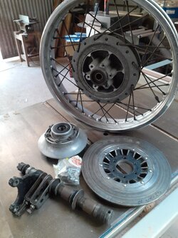

I inherited a 1976 3CL a with a proper alloy rear wheel, but it has a wire wheel on the front. Options are to:
a) leave it as is,
b) proper alloy on front to make spec,
c) non-OEM--find a wire rear wheel, but keep the rotor, (I wouldn't want a rear drum wire like previous versions).
I like wire wheels, (option c )so question ....
Does anyone know of a rear wire wheel with rotor that would substitute and come close to fitting the 3CL?

I've done two conversions with Kawasaki Z1000 rear hubs (and know of one other). Very strong hub, unbreakable - but requires a 20mm axle (easy job to file out the swingarm axle slot and chain tensioners). I was also able to use the Kawasaki disc rotor carrier and the Brembo M6 bolt pattern fitted with a very small (maybe 0.5mm) filing of the holes in the carrier - can't guarantee alignment with std Brembo rear caliper mount, but disc could be spaced; I made up my own floating carrier. Having said that, I think these hubs are rarer than rocking horse shaez! The Suzuki conversion is probably more common - but I'll hazard a guess that these are also very hard to come by.
For the SFQ I scored a Triumph Legend 900 rear spoked wheel complete. Very nice hub but had to do some major metal removal from the sprocket carrier to reduce the wide chainline. Another option is a Kawasaki KLR650 rear hub - I scored one of these for $120 from a wrecker and it has the 17mm axle. Lighter and probably strong enough, being a dirt bike wheel. I was going to use that until the Legend wheel came up, complete with 17x4.25" Akront alloy rim. A Moto Officina rear spoked hub/wheels costs about as much as a decent SF!!

SFC1000 wire rear hub will drop straight in and accepts the cush drive as well as the standard Brembo rotor.

Try finding a wire spoked rear wheel that carries a disc ........ unless you want to start adapting wheels from other makes of bikes.

The only Laverda wheel that is spoked and carries a disc that I am aware of is an SFC wheel. They are very difficult to obtain and will likely cost mucho dinero.
I am not sure what other options are available but I do recall that someone made a wheel from an early GS Suzuki work and if I recall the photos it looked quite good. I do hope that someone who knows more will fill in with the required information.
