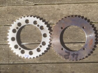

I've attached a photo of my spare rear sprockets. You could probably twist my arm to part with the 40T aluminium one, but it wouldn't be a give-away item.
