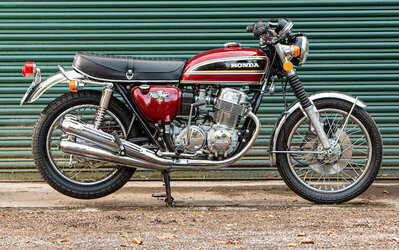

Which is probably why it does match well---- MC manufacturers are notorious for copying each other's design when they can, so many times you will see equivalent dimensions.
Case in point: pic- Laverda 3CL or Honda CB750.....😉

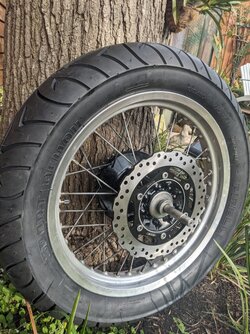

The 3CL's new (1992) rear wire disc wheel- my fleabay KLR650 wheel now refurbished with new bearings, rotor, tyre, buffed alloy rim, paint, and modified KLR calipers.
Fits well with the need to make just one new axle spacer and a brace for the caliper assembly.
Front wire wheel doesn't feel lonely anymore.

Good result, will there be a sudden rush on KLR650 rear wheels on ebay?
bazzee
ps what are the weights of the original wheel and the replacement wheel?

Good questions there bazee and Vince.
Here are the numbers-----
Comparing like for like, so both 3CL and KLR wheels have rotors, but no cush sprockets. Tyres on both:
Weight:
3CL = 16.8 kg
KLR = 12.5kg
knocks 4.3 kg off un-sprung weight!
Diameter:
3CL = 650 cm / 25.5 in
KLR = 640 cm/ 25.2 in
So only 0.15 in between 17 in and 18 in wheel.
3CL rim width = 3 1/2 in
KLR rim width = 3 1/4 in
(corrected)
Reason for small difference--
Tyres:
3CL Tyre = 130/80-18 Metzler Lasertec
KLR Tyre = 130/80-17 Pirelli Sport Demon
I think it has to do with the way the tyres sit within the rims.
The KLR bead is high in the rim, the 3CL low in the rim.
So even though they are both 130/80, there is more tyre above the rim on the KLR, and the narrower rim changes the shape.

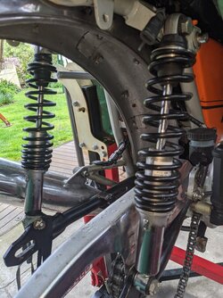

I put these IKON rear shocks on a few years ago. https://www.ikonsuspension.com/product/7610-1397/
