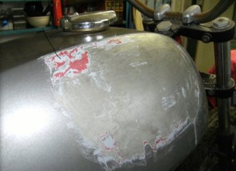

So, I’ve had to consider options and ‘bite the bullet’ and in the photo above you can see where I’ve partially drilled out the spot welds on this vertical mounting plate.
Once I’d prised this little bracket off, the tank looked like this…(photo 'Tank 7')
Yeah, not pretty but necessary, and clearly the top ‘little’ hole was a bit more substantial. Isn't it always!!

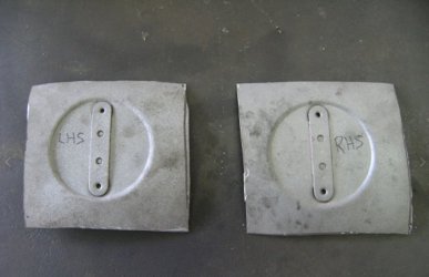

Now I need to make the vertical indent for the mounting bracket that I took from the tank. To do that I’ve made another pressing tool, shown on the right in the photo below. The darker coloured piece, on the far right, is made out of steel, as I wanted something a bit thicker than the surrounding 3mm aluminium. The steel bit is 5mm thick. This is ‘press #2’, both parts of it are shown below.
And below you can see all 3 pressing tools together with the nearly finished product in the bottom right of the photo.
All that remains is for this shaped piece of metal to be bent into the curvature that replicates the area of the tank where this repair needs to be welded into place. I’ll get onto that sometime soon, I need to source a MIG welder for this coming task!

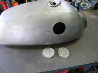

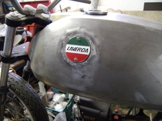

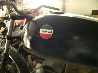

I seem to recall that someone on here successfully inserted a pair of "round badge" panels into a "non-badge" tank.
Possibly in the "Latest Media" photos at the top of the page.
I have a round badge tank which someone had converted to the later type (sort of) I inspected the inside with a camera and could see no damage and inspected the round badge shape etc so I assumed it was just full of filler on the outside and the quickest way to remove it was with a bit of heat.
That worked a treat until I reached a flat metal surface underneath which puzzled me ...... until all the lead melted and dripped on the floor.
I thought ok that will clean up and then I saw that it was full of braze as well. What a bloody mess it is now, it had new red paint on it as well ha ha!
I'm not sure if the braze can be removed, maybe someone can tell me.

About the post with the tank badge area inserted into a tank, interesting that the person chose to insert them as circles. Also not sure, but it looks like they perhaps soldered these in place?? Would be a way to not have the surrounding metal warp with too much heat from an oxy torch?
