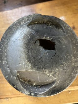

One reason for this choice is that parts for points are difficult to source, and potentially impossible in future. Another reason is to avoid a repeat of picture below -

That piston doesn't look like the result of the ignition system to me! You can also adapt systems that retain the mechanical advance - I ran a Suzuki GS backing, plate, trigger and little black box for years. Never missed a beat.
Sachse are plug and play. I also believe Redax has Ignitech as a ready to install unit. Take note of the comments regarding why that piston looks like it does. If that happened with gentle riding it wasn't the points at fault.
I would stick with points ( points didn’t cause your piston to hole) because you already have them, just plonk a new set on ( VW points with pin removed ) set them up with a strobe and your away. I have original 1969 points, new coils ( VW) and new condensers - starts instantly, runs fine- ideal. Holed piston could well be weak mixture ..
That holed piston was in 1980/1. Was standard GTL carbs, air filter, no air leaks, tappets all good, NGK B9ES, engine had about 18k miles on and had never had oil in longer than 1500 miles. Was riding up M1 late at night, throttle fairly wide open, will have been on main jet. My understanding is that holes usually caused by air leak, plug to hot, bad timing. I used to strobe the timing, but I’ve read that the advance mech requires lubing and I’m not sure I was on top of that. I like the idea of no maintenence electronic, and so many on here say it transforms the bike.

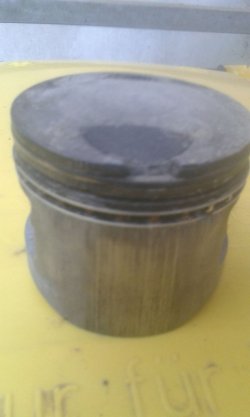

"My understanding is that holes usually caused by air leak."
No,an air leak causes damages/seizures at the intake side
of the piston.

Another way is restrictions in fuel flow, guess how I know. I had a Bonnie that did exactly that. Being young and dumb, I swapped a twin carb head to a single carb and used a carb jetted for the twin carb setup. Massivly lean jetting and then flogged the arse of it up a big hill chasing 2 much later faster bikes. I was wondering what that marbles-in-a-can sound was. It was fun till it became extremely expensive.
of the piston.
Air leak? Not necessarily - a piston will always cook on the inlet side and the cause can be a lean-out caused by low float height, insufficient fuel flow from the taps, lean jetting ... or an air leak.

If you were running 9s it won't have been the pliugs. 8s maybe ... but 7s - which Teddy on here is running in his brand new rebuilt SF2 will absolutely hole a piston. We're yet to hear back from him after several of us on here were flabbergasted to read that he was running those plugs. I hope you're not stranded out in BFN with a holed slug, Teddy!!
I had a habit of turning on just the one fuel tap (i was young, knew no better), bet that was the cause. I was religious about timing and oil back in those days.
:eek::eek::eek::eek: I hate to ask - but you didn't think it would improve your fuel economy did you?! :ROFLMAO::ROFLMAO::ROFLMAO::ROFLMAO:
