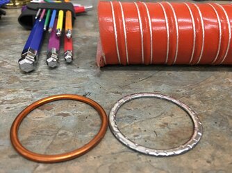

my left hand header needs moving to get the strainer cleanly out - so in theory needs a new exhaust sealing ring and copper nuts each time
I read the whole thread to see a reaction to that message!🤪🤪 is it really necessary to change the copper sealing ring everytime?? If that is the case… where do you find them without paying ridiculous sums on ebay?
Miguel
I only change them if they're leaking and I don't ever remember changing the nuts except a couple of times they have fallen off.
Back fire usually tells me they're either loose or leaking
They are crushable so once crushed they won’t seal as well second time around - cheap enough from Phil Todd - if I don’t replace them one of the exhausts will show a valve guide oil leakage - I should say this is just my opinion 😀
