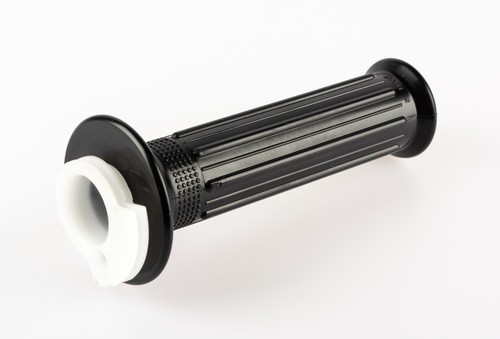

Something I've thought would be interesting to try would be a rising rate throttle. Starts off with slow throttle opening from idle and gets quicker as you turn the twistgrip further. It would need a spiral shaped cable pulley. There's not a lot of space to do that in the standard throttle housing though.
I thought I'd invented something until I googled it and found that Motion Pro already does it.

You must have missed my posts (I've mentioned this twice over the years), Cam. I 'invented' the rising rate twist grip when I modified a KX Kawasaki dirtbike throttle tube (which it still fits inside the ND housing0. I drilled a hole for the cable nipple closer to the inside edge and ground/filed the plastic 'cam' to the shape i wanted - still have it in the shed. It works a treat, plenty of feel on low throttle openings then rising rate to give full throttle at about 1/4 turn. Reckon that was in 1989 - so it's definitely MY invention :ROFLMAO: :ROFLMAO: :ROFLMAO:
