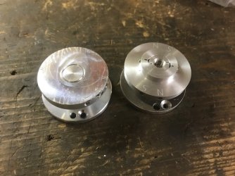

.. the Sachse rotor/adapter plate is a two-piece affair, and in my case it didn't run true ..
It was a two-piece item ..
It isn't anymore .. hopefully ..
This rotor disk (with radial screws and magnets) has been improved for a long time.
Same for the P2H pickup.
Dead simple to install.
Plug and forget.
