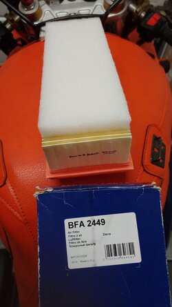

I cut the paper from mine and glued a foam filter in place.

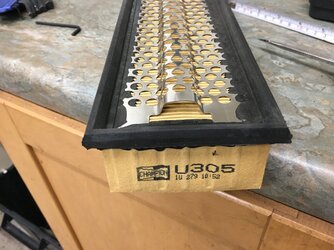

an update - a Fiat Punto 1.1 petrol engine air filter has two of the right dimensions 49mm x 90mm but the length is short by 30mm - however not that difficult to cut and make a join by using two - this will fit a Zane 750 as well - the uber filter is a Champion U305 if you can get one which has a metal support as well - this will go unaltered into both 2021-08-27 17.02.35.jpg 2021-08-31 16.00.56.jpg

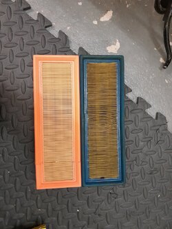

I’ve used an air filter listed for a Fiat Punto 1.2, no need to modify to fit in the air box. Equivalent is also MANN C2859.
The only differences to be aware of is the added foam strip on top of the cassette, which can be removed but it doesn't seem to make any difference and the rubber moulding is slightly thicker which makes it a tight fit in the air box but I use silicone lubricant on the rubber moulding overcomes this. It may be other manufacturers have different thicknesses in the rubber moulding as Jouni’s observation. Cost around £5.

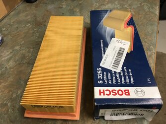

Bosch filter arrived today so cut it down to fit then used silicon seal and a couple of metal pins made from a large paper clip to secure the two sections together. I don't know if the RGS and SFC1000 share the same air box but the Bosch S3337 fits snuggly in the SFC1000 air box. I cut it down so that I needed to fix a 30mm (in length) end piece and then after the silicon had gone off installed with the attached end to the outside, I did this incase the attached short end came away on removal I would be able to easily extract the rest.
The S3337 is a more snug fit in the air box sliders that the champion U305 that was in previously but didn't need any silicon grease or similar to get it in/out.

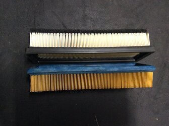

Cut and joined 2 Fiat Punto 1.1 air filters together with super glue. Bought 3 and made 2 filters for £16. Fitted nice and snug.
