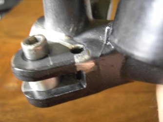

Snapped off the lower support for the lever, managed to get the lever mounted using just the upper support which was good enough to help get it on and off Ian DeLaines trailor but not safe enough to try and ride home on.
No great problem fixing that, have done it several times!

Bit reluctant to risk a repaired m/c on something as critical as the front brakes but that's just me. No criticism with regards to your repair Piet, just peace of mind on my part.

"Bit reluctant to risk a repaired m/c on something as critical as the front brakes but that's just me."
so you wouldn't ride around on a frame (or chassis) that consists of a pile of bent and straight tubes welded together then.
Piets repaired item could actually be stronger than stock, probably is.
