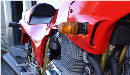

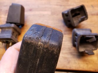

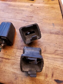

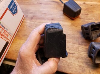

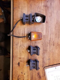

Will any of these help?

Wolfgang has found me a used housing and new lens. The rubber mount appears to still be OK.
He says parts for the turn signal other than the lens, are not available anywhere. So it looks like it's time to wrap them up and put them away and fit modern turn signals.
