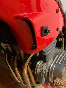

I know these are not for the purists - but took off the original indicators and replaced with mini ones. Mounted on 5mm insertion rubber to fit the fairing recesses.
I've ordered some replacement indicators off a Ducati Monster however those for a K100 look a better option - and the possibility of replacement Laverda ones could be even better.
I tend to agree - not ideal - but they do the job and I cannot see them when riding. You are not the first to make this comment....!
