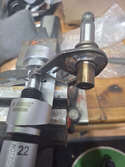

Before I start selecting which hammer to use - does anyone have advice on fitting a replacement selector hook to the gear change selector plate?Gear-selector-hook_01.jpg

All the parts I have are new so that's the reason I was looking for advice on riveting the hook in place - just wanted to avoid any common mistakes.

Just want to be sure that I don't make any stupid mistakes when riveting the pivot post at the back of the selector plate.

Thanks Rob - just looking for advice on riveting the two items together - prepared to do what it takes to set-up after riveting and fitting.

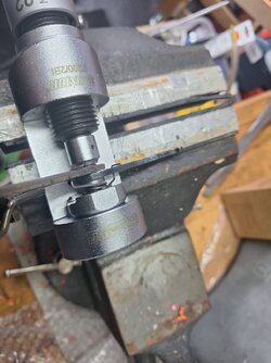

make a sliver of a shim to go between the two moving parts, (say 15thou) then fashion a mandrell to fit inside and over the rivet end, to derive the same profile as your existing one, do the compression bit by using a hydraulic press, remove shim and bingo, as long as the rivet hasnt swelled in the thickness of the two parts

For similar jobs in the past, I always used paper ilo the shim and then burn the paper away at the end

Thanks Clem - guess I can find a snap rivet tool somewhere on line & use a hammer, an hydraulic press though?

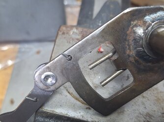

Eureka moment appeared in the night - used my drive chain riveting tool in the vice.
Much more control during the process with a 0,1mm gap all around.
Thanks to Clem & Robin for the inspiration.
Now the tinkering starts 😁
