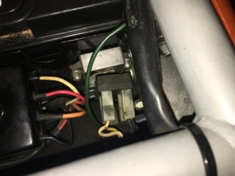

So it?s a diagnostic race? Just found a blown 10amp fuse but I think it?s unrelated. Also, should the guts of the regulator thingy be hanging out like this??
No! Recommend you disconnect everything from the unit that looks as though it may have faulted.
Check battery volts - before and during starting
Blowing a fuse is never OK - standard wiring?  If so I assume the 10A fuse is in place of the usual 8A item.  Wonder if that is on the black wire that provides voltage sensing to the reg/rect?  It obviously needs replacing, along with the reg/rect if it has faulted.

I managed to stick it back in (And now cannot get it out) but is it buggered anyway and needs replacing as a matter of course? How would you test it anyway?
Did I say 10amp? I did, I meant 8amp and that?s what blew.
