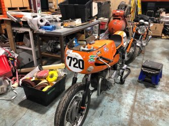

for some context, subject to confirmation it's an 1972(?) SF2 based track bike, but I think it's a bit of a mishmash, currently on a fact finding mission about it.
based in Midlands UK, have just tried to upload pics but way too big so will reduce size this evening.
the instruments i'm after are speedo/tacho, it has a tacho fitted at present but it's non-standard and isn't secured.

Could be a 72 SF, not SF2.
Are frame and engine numbers matching?
In any case, 72 would be numbers between 7 or 8000 and 13000 or thereabouts.
Instruments would have been ND. Laverda specific, Honda ones have a different drive ratio.

Looking at the racer's exhaust - the side stand lug may have been cut off the frame? Not sure about a ND Honda speedo -the Honda tacho isn't right for a Laverda. Notice it has a standard front brake - was it raced with that?? - Regards - Phil
If stand lugs are cut off it would be better to use an SFC type centrestand with lugs to suit, for more ground clearance with the pipes tucked in under. It will be hard to fit a side stand if you keep the 2 into 1.

True - but I grafted a triple stand on to mine - works a treat and uses a useless (on the triples) stand! - Regards - Phil
Yes - I tracked down the chap in Ontario and he advised it was underbraked, especially as the power unit has been "breathed on":) :)
