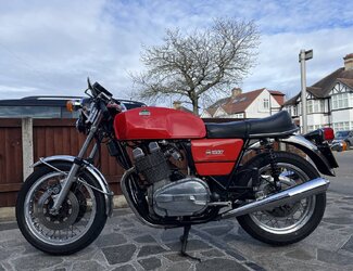

However, after a chance conversation with Malcolm Cox about a TT-1 RGS replica he was building, I thought I might give the Brembo four pots, as fitted to the BMW R1200C, a try.
I sourced a set, taken from a 38,000 miler, at a cost of £138/$175.
On my Ceriani forked bike, all that is needed ar a couple of 5mm. spacers, each side and a set of 5mm. longer bolts, to attach them with.
They vastly improved the retardation but, more especially, the degree of feel.
I cannot imagine that I would ever go back to the PO8s, myself, but I have retained them, in case the bike's second custodian is more interested in originality than rideability.

Thanks. That seems like a better route than going with the gold Brembos with the 65mm bolt spacing and an adaptor, and there's a nice looking set on ebay for $145. Did you use the stock master cylinder or change out as well?
Yes, it is the original Brembo master cylinder.

Upgrading the single F08 on the original BMW R80/100GS to the caliper in the photo above is/was a standard upgrade to the horribly underbraked original. I did it on a friend's and it was a huge improvement.

I see that the calipers are mounted backwards, with the smaller piston trailing. I wonder if they would feel better/worse, work better/worse mounted to the rear of the forks with the small piston leading? I can recall when the 4-pots first came out and the manufacturers made a big deal about the reasons for the unequal sized pistons.
