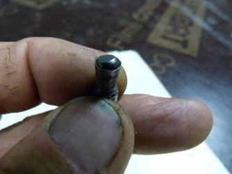

I found one of the screws of the trident, it is not metric, very English, 7.73mm .... In any case this bike was a real shit, engine exploded 23000km
