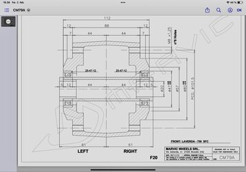

In the proces of ordering a set of Marvic wheels, to replace the the Oscams it was born with. Trouble is that they don’t have any dimension data for the hubs for that bike. Does anyone have that?
They sent me what they have for the SFC 750- shown below. That’s the sort of data they need.

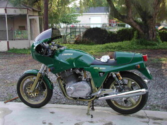

Actually I sent them a picture a picture of your beatefull bike and others, with Marvic Streamline wheels to prove that some SFC 1000 had Marvic wheels. They commented that the rear wheels were mounted the wrong way around because of the chain on mounted on the right hand side. The streamlines are still made today, but as you hint, only i 17” versions. It’s the best looking wheel ever made, but I am going for a 18” replica of the original Campagnolo wheel that came out in 1973 and revolutionized Grand Prix racing. Trouble is, that they lost the data they had for our bikes,
I don't believe any SFC1000 had Marvic wheels from the factory. My bike when new was a 1988 SFC1000 classic with wire wheels which I still have. The first owner also did the brake upgrade and the Ohlin shocks and painted it orange. I also was received another set of body work in green which I fitted and it looks better green.
Doing a little research, the 1988 Bimota YB4 (street version) had 17" Oscam wheels and the YB4R (race version) had 17" Marvic wheels. So I don't know what the 18" wheels on my bike came from? Ducati maybe? The only 18" wheels Marvic still makes are the five and seven spoke version. The three spoke version is only 17".

Of interest to @RGSFC is the little gem of information via @ozijotati that SFC1000 wheels have a smaller dimension between the front disk attachment faces than all other twin disk Laverdas. So don't use the dimension 88mm as per the above drawing, check an actual SFC1000 to confirm the size, probably 86mm or so. This was narrowed to allow clearance for the protruding bobbins of the floating disks when combined with the larger M1R forks. Be careful!
Best regards

Thank you so much breganzane, ozijotati and Paul for that goldmine of information- this can bring me closer to the goal👍
