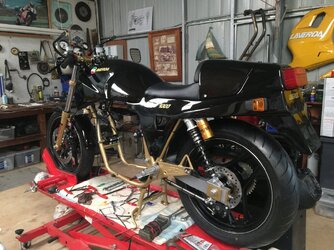

I also own an SFC 1000 with Marvic 18" wheels. #3200 from 1986.
They were on it when I purchased it about 14 years ago. Like 1200TS's bike it also came with Ohlins shocks.
The Bike was imported into Australia from the States and other than painting the wheels black and fritting a Wolfgang Stainless Exhaust system and Mikuni carb's I have not really touched it.
When it was time to replace drive sprockets, I found that Ducati sprockets were a straight fit onto the rear cush drive. The local Ducati guy's where I got the sprocket told me they thought the wheels and brakes were probably off a Ducati 888. Others have told me they are probably off a Bimota.

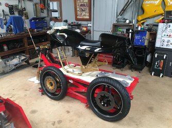

The first pic shows the Bike as I got it and the second one is after I had painted the wheels black and new pipes and carbs.
A few years ago I bought another SFC1000 #3174 and through the process of restoring what was a very unloved machine I restored the Ozcams but ended up putting them aside due to their excessive weight.
The third pic shows the Ozcams that are now leaning against a wall in my shed.
For this bike I have gone the Suzuki wheel route (thanks to Red) and really like the look of the Suzuki rims. See fourth pic.
What I have learnt is that changing wheels is not a plug and play exercise as you will need to look at everything in relation to every other thing, Calliper adaptors are a good example of that!
I can do some measuring for you if you need.
Cheers
