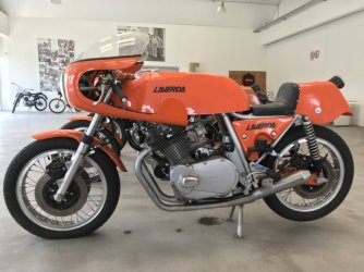

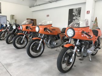

Look these from en in Breganze

There are plenty of nice SFCs for sale out there, so this one had better be cheap.
Apart from the sprocket and discs, what isn't conform to type on this one?

Is anyone going to inform us "poor" peasants what's not correct about it?
Do we have to count the teeth on the rear sprocket to check it's the correct one?
Drilled discs not period?
Or is there more photos on the link that I have not found showing a MZ badge on the other side of the engine case?
Helpful full answers would be appreciated " I might win the lottery tonight" and would not like to be pointed at or tittered at , at the next Willersey gathering.

Well, I recommend that no one here go out and buy an SFC, at least not at market price.
Without going into detail, the discs are wrong, as are the carriers.
Number is 18380, it's an Electronica, which I don't think would have left the factory with cast wheels. One must presume that the engine number matches.
Were I interested, I'd give the selector come oil filler cover a knock to hear it ring, I'd be surprised if it were the original magnesium.
Intake trumpets should be grey plastic, not turned alloy. Carbs, like the sprocket are maintenance item and finding original PHBs nowadays is tough.
Were I to ride it, I'd put collars between the exhaust tubes and the 2/1 collector.
Maybe the wheels and the selector cover ended up on a replica pretending to be the real thing? Stranger things have been seen.
