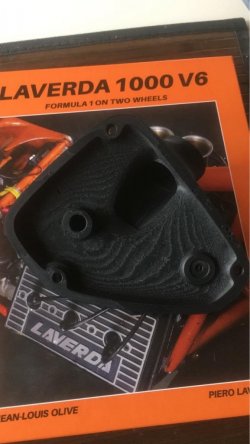

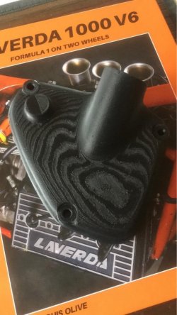

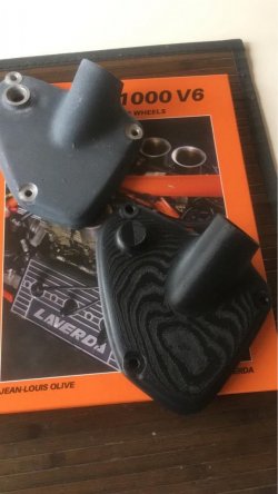

Today: I have 3D print a SFC engine cover, now I Will make it ready for casting.
Br Peder Heise.

I guess I was under the impression that the 3D printed part would be used for the mould for casting a new cover.
What do I know? Nothing.
Jim
You could use it to make a sand cast around, the 3 d print I imagine will be the model which the sand is compressed around.
I would be interested in casting a magnesium one, if not that I would Have it machined up on a CNC machine in Ali
Yes the 3D print is for a mould, and is 1,5 % bigger. Now I Will make is ready for casting, the cover is for my Spaceframe.
Interesting comment , but I have to say some of the stuff we get is pretty poor quality. I bought exactly this part from a “usual supplier in Europe”, and when my engine was with Red, I asked him to send it with the rest of my cases to get blasted , it was such poor quality we couldn’t do anything but fill and paint it again.
Yes I have the same cover and when stripped it did have some pitting from the casting, Im just going to fill with weld and polish up, no drama.
