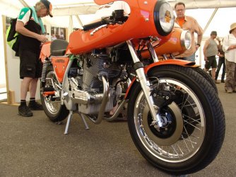

Agreed but it really was stunning. A genuine SFC electronica, the only real thing I questioned was the painted finish on the frame as I thought it should just be galvanised but was told it had been restored with paint for practical purposes.
Very nice machine! It looks showroom-fresh. I was actually looking for the VIN plate on the frame. Would it have been removed for painting or did some year/series of the sfc not have one?
