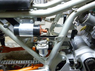

my frame was galvanized, in a company that does galvanization for a small price, and the result is good, but it had to pierce the tubes as Wolfang says. and the end result is good
