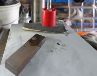

use an oil stone and reduce the thickness of 2 of your spare shims and you are done.
Thanks Clem, I can do that but hoped to find the right size shims & exchange for unmolested ones to keep them in the mix (if there's a shortage ?) but even then I'm stuck without the valve collet (or half cone as described in the parts list).
I may end up buying them from Red!
Use a Lathe nschine
Sort of, but as I don't have a lathe I tried a bolt faced off with a round neodymium super magnet fitted, which tended to move, tried super glue, no good so added a washer to keep centralised with a plastic sleeve to keep that from wandering about & filled with epoxy.
Works well with the work surface level first and needs an air line to blow the filings away. Used the aluminium oxide abrasive paper in the background & an India stone, finally finishing by hand & checking with a micrometer to ensure it is actually a level thickness.
Quicker than by hand & easier to keep level I think, but I'd rather not do it.
