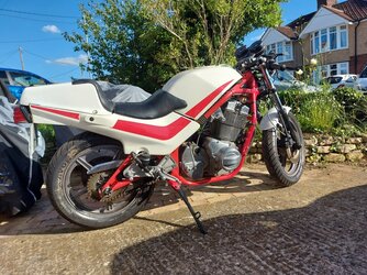

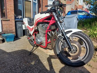

Is that a sunny day I see there nah cant beSo a busy week off work. Got the RGS and Daytona MOT'd, learnt how to do some fibre glass repairs to the faing and seat unit. Pick up a replacement screen tomorrow. I spent the best part of yesterday trying to resolve why it would not engage top gear. Read and reread the forum posts on setting it up correctly. The only thing I found was the eccentric adjuster was loose. So I had another go this morning. Pretty quickly I found that the selector drum only had 3 pins in it. The thrust washer obscured the pins. Had a fish around but couldn't find it. Fitted a spare and set it up as per the forum advice and it now has 5 gears and engages neutral real sweet.
