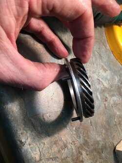

Needed to get the wheels off my Corsa for tyre change and noticed that the front wheel bearing were notchy - lhs with my new chinky bearing puller one minute - speedo side not so easy the modified speedo ring is mounted on a hub that obscures the bearing - this requires removal but it is on there big time with loctite or something - have used my wifes kitchen blow lamp and my 2000 heat gun but no dice - i had the ILOC club puller but in this case there is not the clearance under the speedo gear to use it - the gear obscures 4 small screws that allow you to remove the hub - i noticed the screws were all loose so i managed to manually get them out - replaced the bearing in 30 seconds but now getting the four screws tight is going to be a problem - any suggestions ?
i had wondered if i relieved part of the speedo with my dremel to give me access to the allen head clearly would work ? 2021-02-18 11.14.30.jpg2021-02-18 17.19.45.jpg2021-02-18 17.19.53.jpg

Right I just cut an Allan key with my dremel and I checked that I can successfully tighten the 4 Allan heads when required - only a 2 mm key so not a lot of torque required - bit of blue Hermatite - fortunately the speedo gear is in good nick - there was plenty of grease - I have dressed it up where I tried to rotate it - so thanks Hamish good plan

This one is a bit different Red, I use the bearing bore to locate/centralise the gear mount, thus it obstructs the bearing.
WARM the assembly to soften the Loctite, use the factory puller puller to seperate the parts. The crown gear has been modified to allow the puller to fit over it.
Please be carefull with the hex sockets, they slip quickly if the key doesn't fit snugly.
Reassemble with Loctite on the threads. If the screws need to be replaced, the heads have to be trimmed slightly to fit the brim.
