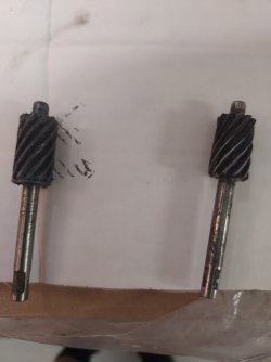

Hello.
I'm taking advantage of this thread to also make my request.
I'm looking for an 11-tooth gear for the Smith Speedo, like the one in the photo. I already have the 22-tooth ring.

I am going to make a bit of a guess here, but there is some foundation, it looks like a Laverda ring gear and it is stamped Veglia. The SFC1000 originally had Smiths clocks which were in stock items at Breganze for 25 or 30 years and were used on the first SFC1000's, this caused a factory recal (due to the grease internally going hard as rock) and a swap for the Veglia instruments that we are more familliar with on this model, it meant changing the clocks (of course) and the drive gear and pinion at the front wheel spindle, this job was entrusted to dealers around the planet, a lot in the UK, the clocks were simple enough to change (many forgot that there would now be an ignition earthing problem) but the drive gears a little bit more time consuming, so was very often NOT DONE, this left the SFC1000 with a vastly overeading speedo (around 25MPH too fast) and similar for the tacho.
