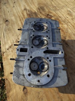

My 1200ts mirage was retrofitted with a Ducati starter that didn't have a Bendix . The starter clutch failed at 8k RPM and exploded the starter. I need the whole assembly if I can find one. I have a jota cylinder head for trades . Valves and springs included 1000000776.jpg
